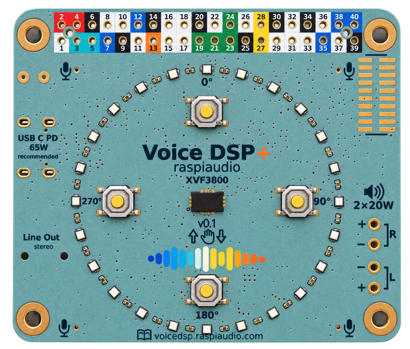

Voice DSP+ Core Board, front view with RGB LEDs, four buttons and gesture sensor

  • Four integrated digital microphones in a square array.
  • Dedicated XVF3800 voice DSP: beamforming, acoustic echo cancellation, noise suppression, dereverberation and automatic gain control.
  • Powerful stereo amplifier: 2 × 25 W capability with suitable 20 V power and 4-ohm speakers.
  • Separate 2 × 2 W stereo outputs for small voice speakers. Speakers are not included.
  • 3.5 mm stereo output for a suitable powered speaker or stereo system, with connection detection and firmware-controlled routing.
  • 24 addressable RGB LEDs for voice direction, status and custom feedback.
  • Four physical buttons with configurable actions.
  • PAJ7620U2 gesture sensor for touch-free controls.
  • 40-pin Raspberry Pi interface plus USB audio operation.
  • External microphone-array connection and 3.3 V Qwiic I2C expansion.

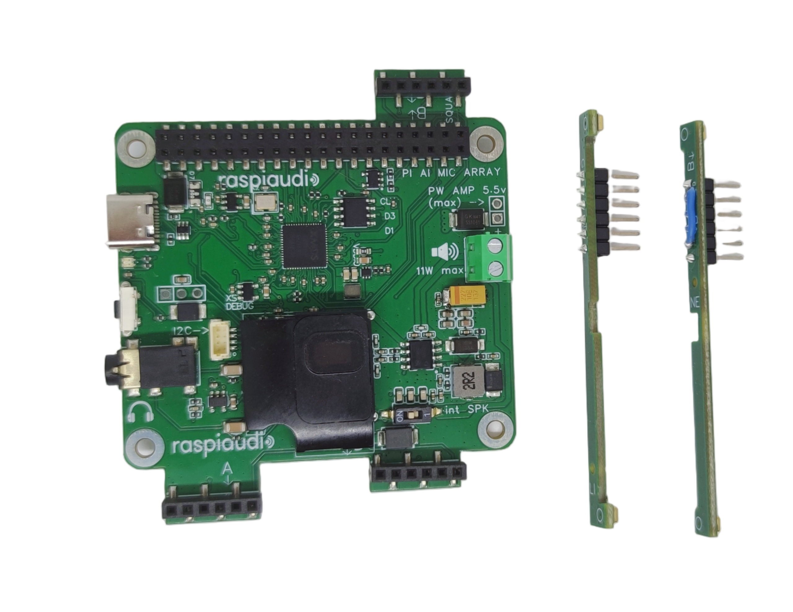

Voice DSP+ Core Board front
Front
Voice DSP+ Core Board rear connections and electronics
Back / the same board
